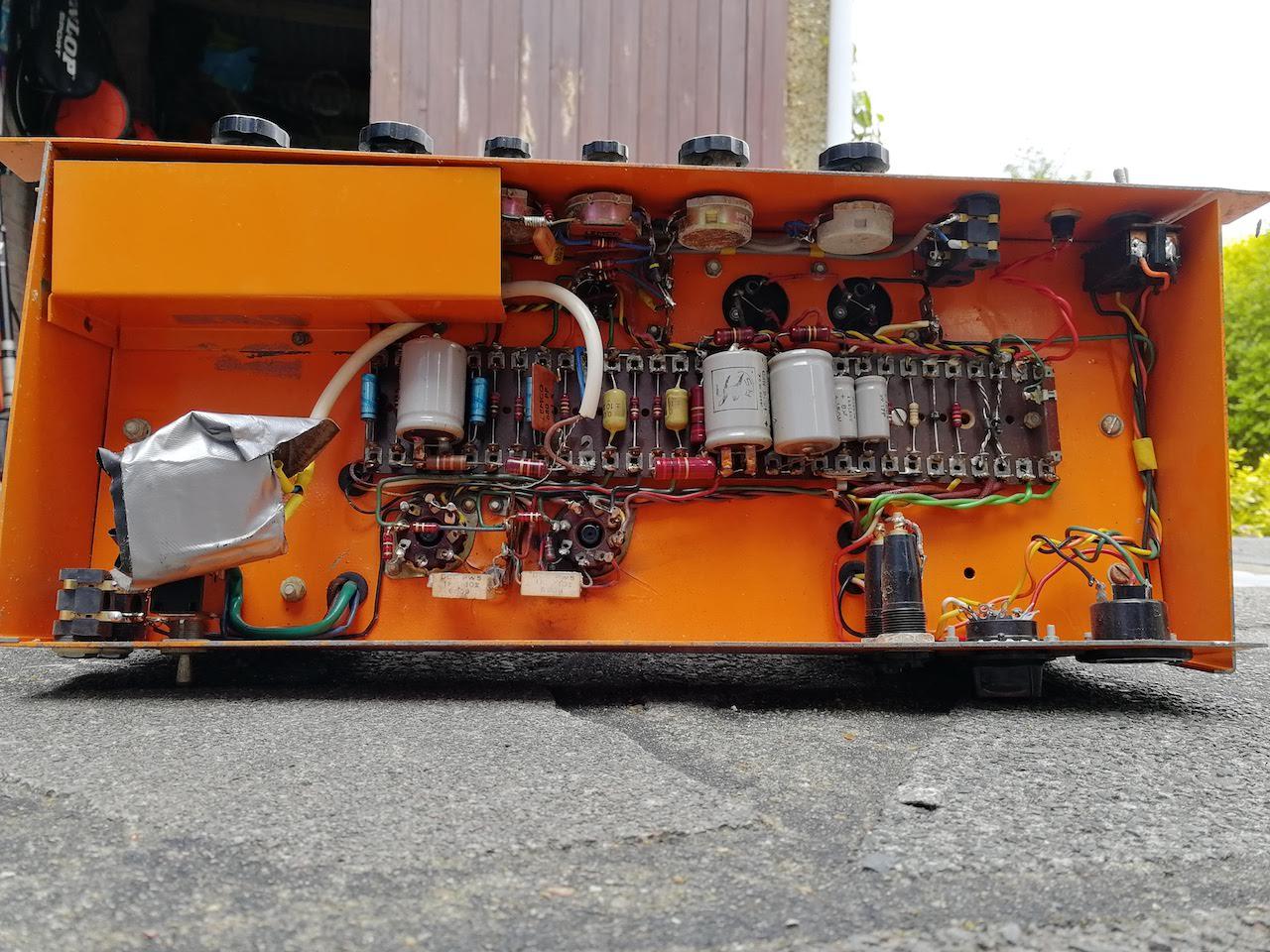

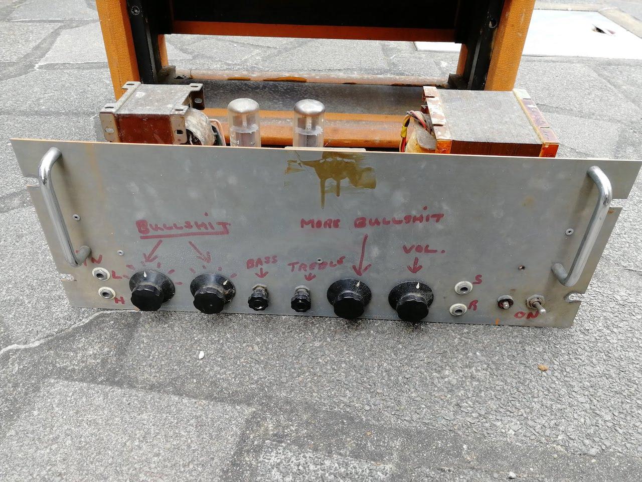

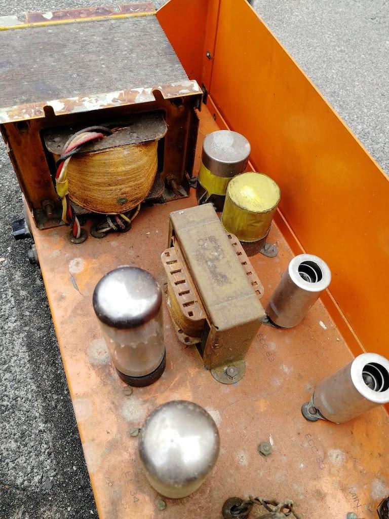

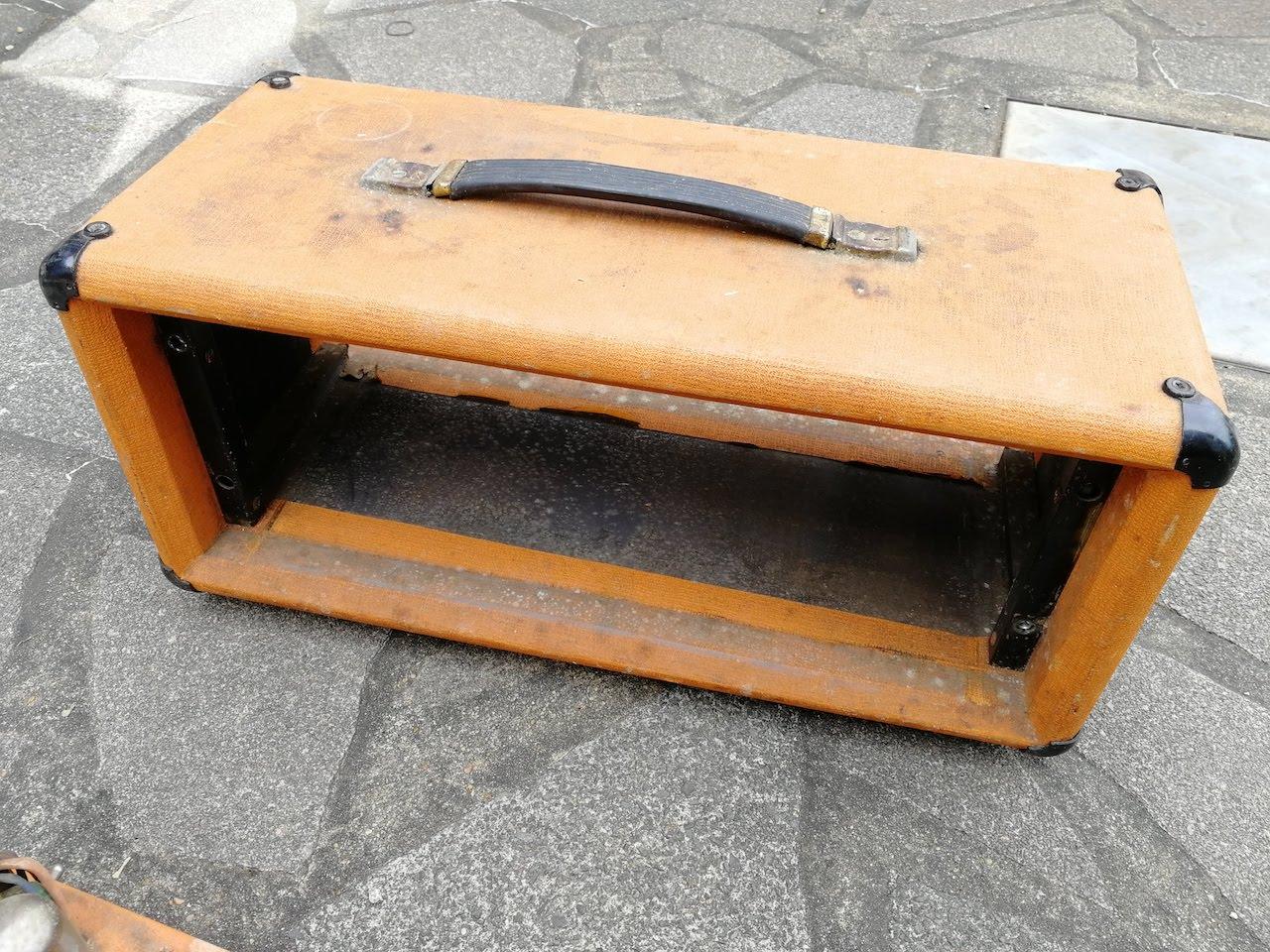

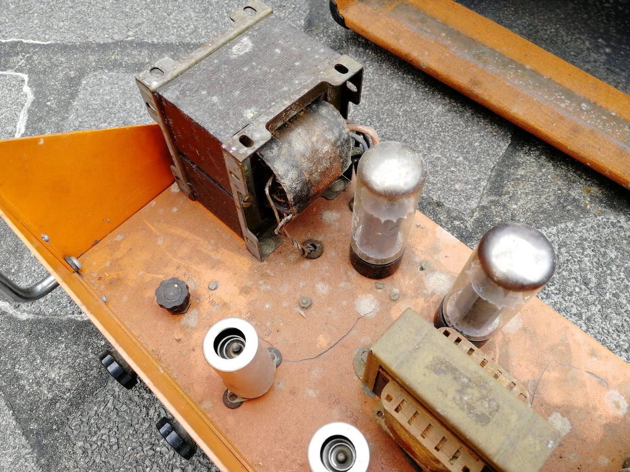

So here are the pictures. It's definitely a project, but if it was me, I would explore getting it fixed. A lot of cleaning needed and as I said to Sam in an email, I think if it was cleaned up he'd feel a little better about it. The good news is, the inside of the chassis is pretty clean already.
What do you think a good value/ asking price would be in the UK?
(and I love the names of the controls...)

Oh! That thing has been under water judging by the top side of the chassis. The underside just looks like it’s been messed with. The labels on the controls basically aren’t wrong.
Re: Old beast I found...Orange Matamp ORST?
Looks like it has had diodes burn up by smoke on the board and changed rectifier diodes, the HT wire from the fuse holder looks charred, something has happened around the EQ and loop stand off - maybe just dirty. I suspect that the UK mains cable soldered to the middle of the board goes to a replacement filter cap hiding under the gaffa tape.
I will pm you, I have the required parts for it and am quite familiar with them.
