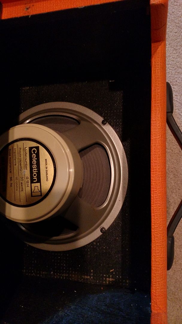

I have used the AD15 a lot over the last 12 years. I have owned many of them and still have some. It's my favorite modern Orange Amp.
The best speakers in to my ears are either a Vintage Celestion G12H that you could find off ebay or the Celestion Alnico Blue.
I take the V30 out of every AD15 I have. It's not the best choice for this amp but I can understand why orange put them in trying to keep cost down.

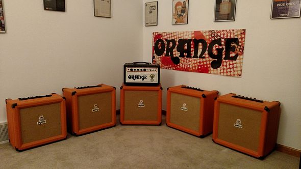

Here's an AD15/10 and four AD15/12's one of them has been modified to a head.

Yea they make a few different versions these days but what i'm talking about is the original Celestion G12H from the 1970s, Its not called anything like a heritage or modern it's just a G12H. So it's clearly going to be a used speaker. You can find one on ebay they pop up fairly often. Just search "vintage celestion G12H" They usually aren't cheap but $175-$300usd will get you a nice original one or even a nice re coned one that will be good to go for years to come yet. The 1970s G12H came in a few different colors too as far as the magnet cover, so don't let that fool you. I have them as Greenbacks, Blackbacks, Creambacks I even have one in a Greyback. Even a Celestion G12M from the 60s-70s would be a great choice. The G12H is a 30 watt speaker and depending what G12M you might stumble across they were either a 20 or 25 Watt speaker.gazman83 wrote: ↑Fri Jul 05, 2019 10:31 pmThanks for the feedback Steamboat

+1 on the G12H-30. For me a pretty perfect match for Oranges. The V.30 is good when there are 2 or more of them but just don't quite do it for me as a singleton.
The current H-30 'Anniversary' model is pretty much the standard model, and nothing wrong with that.
Indeed, the colour of the plastic magnet cover made no difference with the vintage ones. Back in the day the main real differences were between the normal '75Hz resonace' models and the '55Hz' ones which were originally used for bass, but are also great for guitar. They have a bit more low end, otherwise just as brilliant sounding. A '70s Blackback 55Hz one I found years back is still my single favourite all round rock guitar speaker.

Good point on mentioning the Hz. that would be something else to consider but both are great sounding speakers. I have both versions in my AD15s as well as the alnico blue in another one. You can't go wrong with any of these combinations.a.hun wrote: ↑Sat Jul 06, 2019 4:57 pm+1 on the G12H-30. For me a pretty perfect match for Oranges. The V.30 is good when there are 2 or more of them but just don't quite do it for me as a singleton.

I too like the 55z. I have a nice creamback in the cabinet underneath the AD15 head in my picture posted above.
