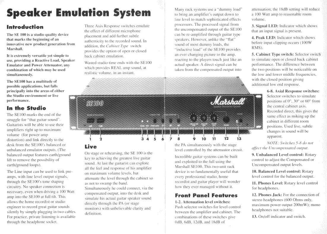

I have used the Marshall SE-100 speaker emulator for recording a lot. They're hard to find, but it would give you exactly what you're looking for.
