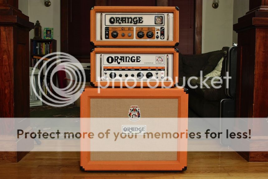

Another plug for the PPC212OB.
It's noticeably lighter and smaller than the closed back cab. It sounds great.
It's the same size as an AD30 combo.
The closed back has more low end oomph, but the clarity and sound spread on the 2x12 is a lot better. I think my PPC212OB is the lightest 2x12 I've owned (speakers being equal...V30s are heavy).
It's barely wider than my old OR heads

In my book the open back 212 is superior to the closed back in every aspect. The fact that it spreads the sound better makes it sound bigger and even louder. The closed back is extremely directional. I don't even think it has more ompf. I'm planning to get rid of my 212CB and buy another 412 insted.
